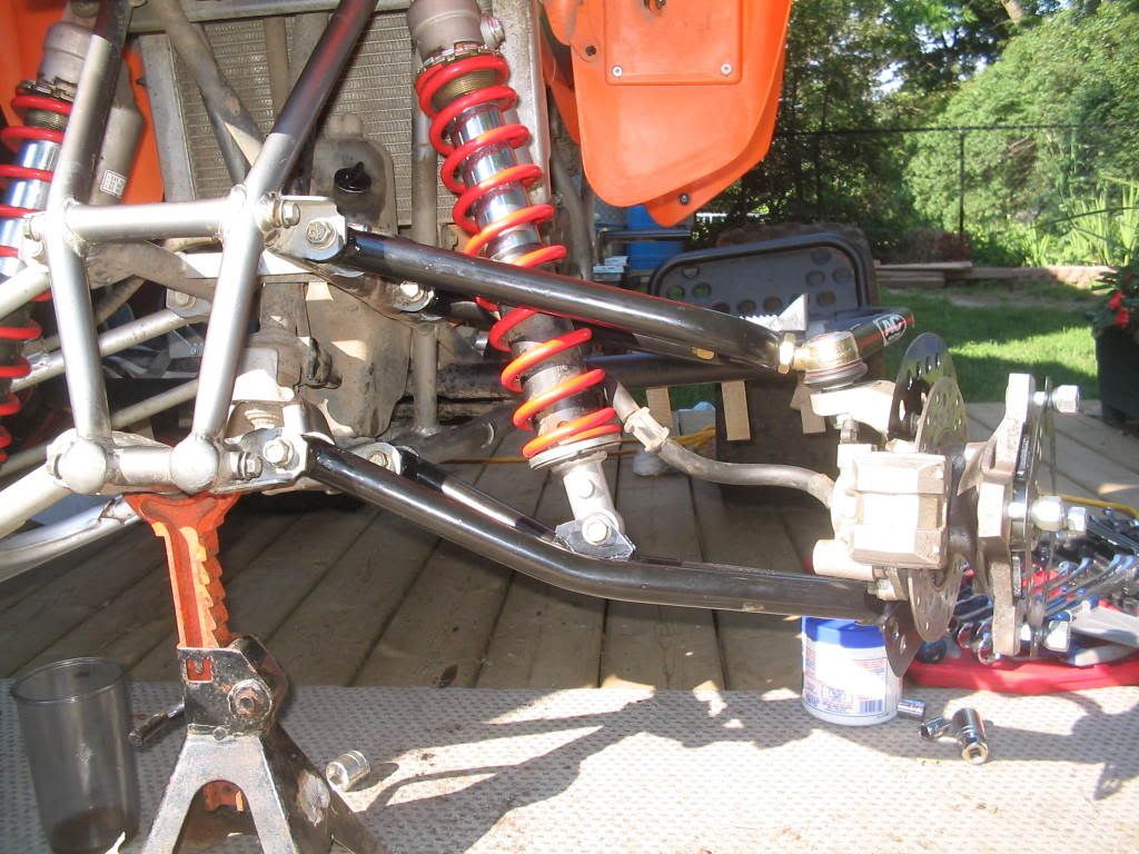

my brother ordered a set of standard travel +2 a-arms(EPIC) and they finally got here today. We opened the box and they looked awesome. As soon as I picked them up I noticed that they had that "gullwing" style on the lower a-arm, so I said to him "Ive never seen standard travel a-arms with this gullwing style, I thought only Long Travel A-arms had that. Anyways he ignored me and put them on his kfx rite away! after they were installed, we stepped back to look at them and realized that it was a lot higher(the quad was off the ground) then the stock set-up. So anyways he called the guy over at golden west cycle, and gave him the serial number on the box, they guy said "yea, those the epic +2 LONG TRAVEL! a-arms, which are worth 800$ US. Anyways he kept his mouth shut about how they sent him the wrong ones, because he knows he can make a profit on them. Anyways here are the pics, and hes just wondering what will happen if he rides with these a-arms, with standard travel shocks(450r shocks) He is selling them forsure to buy standard travels, but we are going riding this weekend, and he needs to know if they will be TOTAL SHIT! or if they will be alright for ONE ride. Well tell me what you guys think about that story, and what you think he should do.

The suspension may feel a bit softer thats about it. There is also a possibility that the frame will hit the ground.

To me they dont look LT. Look at the spindle inclination and also the degree or which each arm is at. They are the same angles and the inclination looks the same in the photo. The shock mounts also look the same. Most LT arms are more towards the spindle, and a DVX, Z, KFX will usually run a 18.25ish shock for LT arms.

they dont look like LT to me...but if they are LT then id just keep em and get shocks...the ride quality is worth the couple extra hundred for shocks

well my brother would keep them and just buy long travel shocks, but they are only +2's, which he says if he ever went long travel, he would go with +3's. He doesnt feel like spending 800$ on LT shocks, set-up for +2 a-arms, and then decide he wants to go to +3's. And yea, he's decided do not ride on them this weekend, put them back in the box they came in, and just put them up for sale. You guys are all thinking that its my quad or something arernt you? its actually my brothers, so I dont have anything to do with it, dont complain.
