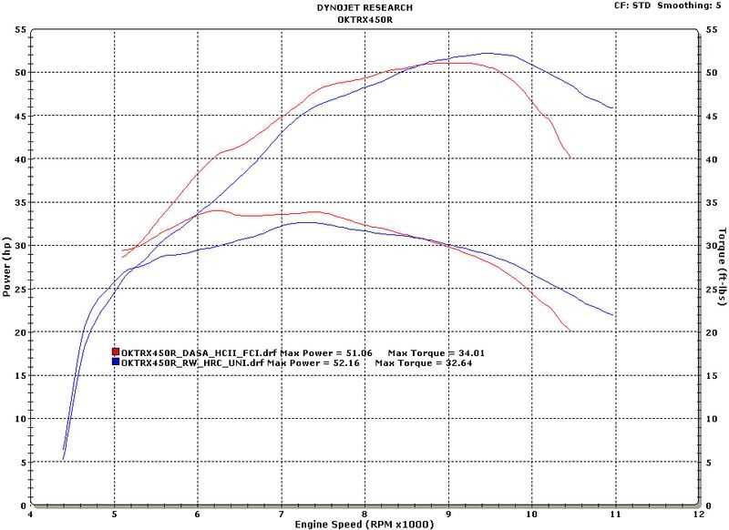

Well, as I stated earlier the kids are very into riding now and 90% of my riding is with them and the wife; I wanted to get a more meaty mid-range for those brief vrooms I get...
Previous Build: Blue
1) 2005 TRX 450R
2) HRC Kit (Cam and breather T)
3) VCP 12.25:1 HH Piston
4) Boone Head, with +1 mm Ex valves, KW springs
5) Dyna FS Ignition (curve 1)
6) Factory air box, Sparks ring, UNI filter, no lid
7) RW pipe
8) 43mm FCR (DASA bored)
9) Dumonde Tech oils
10) 91 Octane pump gas
Current Build: Red
1) 2005 TRX 450R
2) Hot Cams Stage II
6) Fuel Customs Intake
7) DASA pipe
9) Rotella 15W40
Here you go...
And the AF...looks a little fat on bottom, but they had it on there for 2 hours! 230MJ, DJ needle on 9th clip and 2 washers under the needle!

And finally the run conditions...you can see the earlier runs were in much better weather...I know, DJ Dynos are supposed to account for this...I still say the TRX would post better numbers if the temps were back in the 70's with lower humidity...but anyway...

Very nice. Makes it nice to see them stacked on top of each other. I made over 100 pulls on my predator.
the old red trx450 looks like a better dyno curve to me... especially in the mid...
did you get them backwards?
I'm lost when looking at dyno's
Are you still running the auto lube on the Pred as we have two stock ones for my daughters and was just wondering ?
LOL! Nope, not backwards! But, consider this, I have more $$ in the carb and pipe alone on the TRX then I do in the LTR performance upgrades! Bodes well for the LTR! Look at the list of mods on the Honda and to think it is not that much on top of the Suzi!
Well, what you are looking at on the LTR graph is the Red lines which was the factory exhaust minus SA, lid removed and CB...compare it to the Blue lines which is the DASA Ex, Trinity intake (cut airbox), and PIMM. Do not just look at the peak numbers written as max values on the graph...look at the lines. Compare the upper 2 lines which are HP and the lower 2 lines which are Torque.

That is really wierd. With the STG2 HC, I was expecting a meatier midrange and a little loss on top. You found just the opposite! :blink: I'm sure the intake and pipe change are accounting for some/most of this, but that makes me wonder about the dyno's consistancy......... IMO.
None the less, GREAT RUNS! It is cool to see the REAL gains. Thanks for sharing.
Also, did that FCI make that bike THIRSTY or what? :eek:
ERR... WAIT! Maybe you have a mistake on your colors. What you said and the dyno sheet mismatch. If what is on the dyno sheet is right, then that makes sense. The STG2 signed off way early. Plus the RW pipe is maybe just a touch more of a top end oriented pipe?
Yup, he got the colors backwards (he did the same thing over on another site :lol: )
The differences in those two curves are pretty consistent when comparing the HC S2 to the HRC with no other changes. So I'd say the DASA and RW are pulling fairly similar curves, maybe a slight advantage in the 5k-6k range with the DASA.
