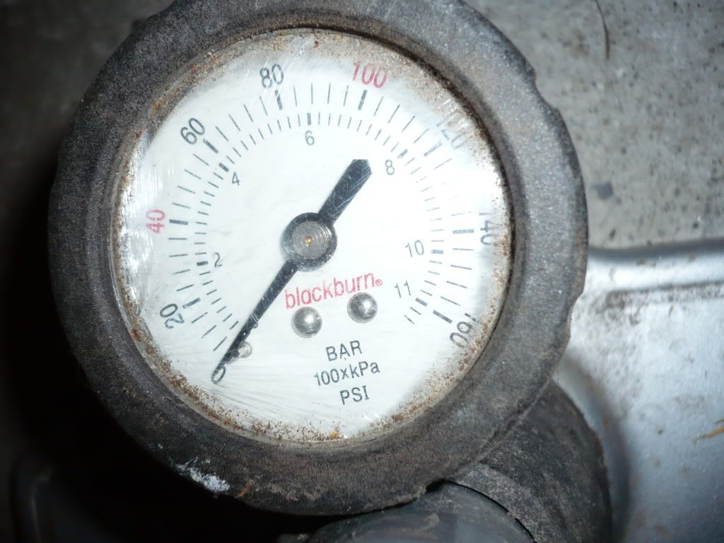

I can’t figure out the connection between BAR, psi and kPa. And when I looked at my pump at home, to get the correct tire pressure on my new LTR, I got even more confused.
At the gas station I fill my car tires with 2.8 BAR, so it don’t make sense that the pressure on the quad is so low (it almost flat).
Please help me figure this out, so I can get the correct tire pressure on my new LTR.

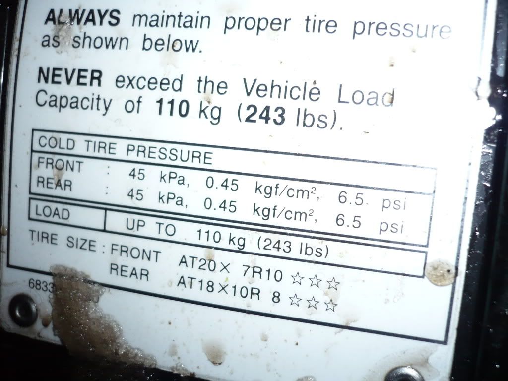

you need to set your tires to .45 bar. You should have received a psi gauge with your new LTR if it is PSI set it to 6.5 psi. The gauge you show is not accurate for setting low psi ATV tires.
and the added link is over pressured

1 bar = 14.5 psi

I just got the machine, but in the future i will ride MX, so lets say 10 psi.
But compared to the pressure on my car (red) is the pressure on the quad (green) very low. Is this true?

yeah....you can't compare a car to a quad.
car about 35psi quad is 6.5psi
