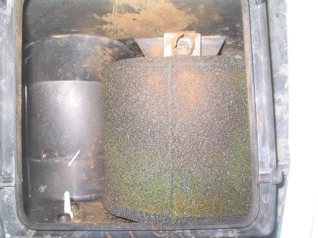

well im not running my air box lid, so my air filter is exposed to EVERYTHING! I ride in very sandy,dusty conditions, and after every single ride I need to clean my filter. It kind of gets expensive doing it after every ride, so Im wondering if any of you guys have thought of something that I could do to cover up the stock filter, so I can get away with cleaning it every 2 or 3 rides instead of 1. I was thinking of just buying an outerwear, and putting it rite over the stock filter, but I dont know if I will run into lean problems or not, or if it will even fit etc... well anyways tell me what you guys think, it would be greatly appreciated.
P.S here is a pic of the filter after one ride....maybe this is normal, but to me it looks dirty as sh*t!!

I have been having this same problem. With the airbox off in dusty conditions my filter has to be cleaned everytime. I dont want to restart the whole debate about foam filters vs. K&N but I will say that the K&N is much easier to clean. I am looking at the Trinity system now to replace it but I am not sure what the impact of that would be to the fuel ratio. Anyone have any idea?

yea but like a lot of people say, stay away from those types of filters in dusty conditions, go with foam. Im pretty sure Im going to order to pro design foam filter, that comes with the outerwear style cover.
If you guys open up those things your definately going to want to go with some kind of aftermarket fuel module...almost everyone will agree that you should go with either the Yoshi or the Power Commander...however...if your funds are limited then one of the lesser "Dobeck" configurations may be more in line with what your running...but something is better than nothing...so start researching before you paint yourself into a corner... :p

Wally.... Junkie is refering to the Pro-Design (or similar). It will let more air in and you will end up lean.
A foam filter with the EHS lid is the way to go for you.

I have the Pro Design foam filter which is a two filter system. My buddies and I rode 5 hours at Little Saraha two weeks ago. I cleaned my filter after our trip and the outer filter had about 3-4 tablespoons of sand in it. The inter filter almost nothing. So having said that I spanked my buddies bikes all day long,yzf 450,06 trx 450. Sure felt good. My suggestion is get rid of the stock filter,it will soon fall apart. My filter fell apart after the first cleaning.
Cut the center out of you lid and put some pantyhose over it. Cheap ehs lid alternative. I did this on the lt250, worked pretty good.
