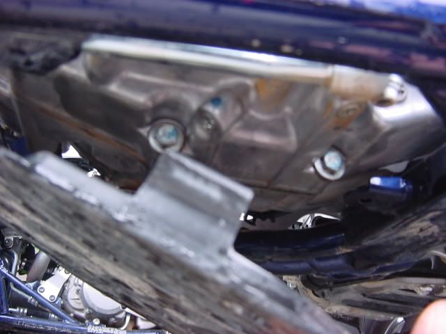

First you have to drop the plastic protector with a #10 socket (God help us if we purchase skid plates :evil: )
Then you pull those 2 engine cap screws with a #10 wrench

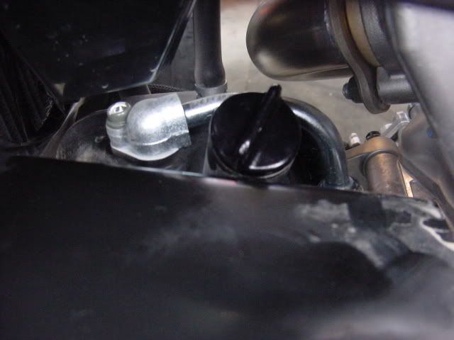

Then you pull the cork on the front oil tank

Re-assemble and add 1.4 quarts into the forward oil tank.

Just hope the aftermarket will put either two slots or one long slot so you can loosen those two bolts without dropping the skid :eek:
I thought about that BUT...where would all the oil go?...<blech> :evil:
