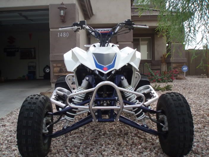

Back the collars out all the way and leave aroub 3 threads showing at the top. Now if you want a really nice, smooth rode on the smaller ruts have the shocks revalved. I weigh 210 lbs and on the small bumps it's just too stiff. On the hard landings the shocks do a fine job of soaking them up. I've heard good things aobut I-shock and their revalve service. I think it's aroung $300 for all 3 shocks.
Take a look at this pic. Look at the rings above the springs. Take a screwdriver or a shock wrench if you have one and turn the top one counterclockwise to loosen it all the way to the top leaving 3 threads showing above the ring. Now turn the one below it all the way up to where the first one is. Now tighten them against each other and you're set. To me even with this adjustment it's just too stiff on the small stuff and that's why I'm going to have mine re-valved.
