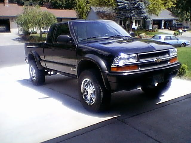

Ok I have a 2000 S-10 ZR2 with the 4.3 liter and I was thinking of gettting a little toy hauler. I really don't want to go with the tent trailer option because it rains so much here in the Northwest. I was just curious if anyone is already doing this or knows someone who is and how its working out. Here is the trailer I was thinking of getting.
Carson Rebel Trailer
Here is my truck:

Nice S-10! Also to help u how much does that trailer cost? If it's a decent price it wouldn't be a bad buy. Also if u are going to have more than one person staying it could be alittle bigger, but for once and awhile company it will be fine.
They go for about $10,000 which is pretty cheap, but there are no bells or whistles on it. I could save $900 on shipping if Junkie or Fuel would drive it up from southern Cal for me, lol. I'm most worried about is pulling that much weight with a mid size truck. I gave them a call today and asked about it, and they told me that what it was designed to be pulled behind but I don't trust sales people. I guess I might have to invest in the hitch and overloads and see if they will let me pull one before I buy it, to make sure it pulls easy.

My mom used to have a ZR2 just like yours only in pewter. That was a fun little truck! Fairly quick and it looks pretty tough for a stock truck. BUT, they are still an S-10 truck. I don't believe it will like the load myself. I think a 1/2 ton truck would love pulling that RV. Yes, you can get a brake controller and load bars(love them) and probably be fine stopping and leveling out the truck, but I think the tranny will take a beatin' if you hit any bigger hills or city traffic with it. It would be nice if they let you try it before you buy it.... just pull it around town some and get on a 65 mph road as well.
JMO
Yeah I figure when I get ready to spend the cash I will get the truck set up first and then take it for a test pull. The dealer said it was designed for a truck like mine and if I'm willing to buy it after the test pull, I don't see why they wouldn't let me take it for a test. Maybe even see if I can put the LTR in the back or leave it in my bed.
Oh and I kick myself is the ass for not getting the pewter. The black looks good when its clean, but the pewter hides dust and rainspots and it kinda sparkles in the sun.
Black is soo tight when clean, but it is hard to keep it that way. :( I, as well as my parents, usually opt for a lighter colored truck so they are easier to keep clean(or appear that way). You are right, the pewter was cake to keep clean and it had a lot of metallic in it. I think GM quit making the pewter and went with a sandstone color which doesn't look as good IMO.
