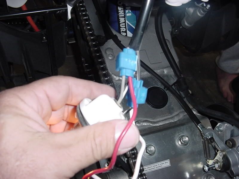

First go to your local Auto Zone and buy this kit...it's in with the trailer hitches and stuff
Look under you quad and find the tailight plug harness
Turn your key on and find voltage so you know which wire to cut into for power
Now take your Auto Zone harness that you bought and cut it in half

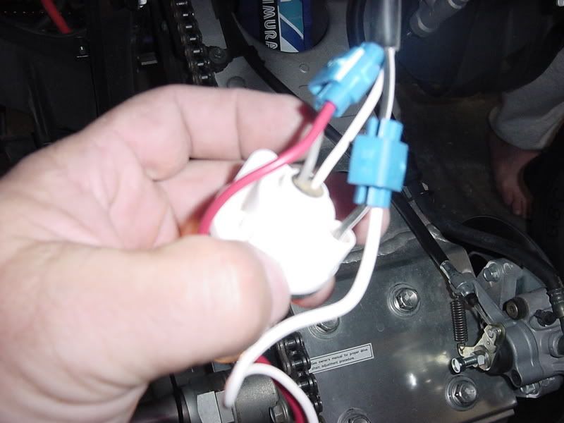

Use blue tap-in connectors to tap into the hot wire and the ground wire nearest the rear light. Use the same wires in the harness you tested back in the begining of the thread
Strip back your wires on the lighted whip
Use butt conectors to connect the other half of the Auto Zone harness to the lighted whip and cover with heat shrink wrap
Now you can plug in the Auto Zone harness to the other half of the Auto Zone harness and test
If you have any problems double check your connections..but it's pretty straight forward. You can do all this without the Auto Zone wiring harness. Some people use just male/female conenctors BUT you could possibly work the wires loose and need new connectors. I liked the finish and fit...and it looks more like a factory harness to me...
And there ya go... :D
The finished product should look like this...

Nice write up junkie. Just one thing make sure to check that your going into the running light cause if you go into the brake light then, he he it will only come on when you the the stoppers. :lol:
