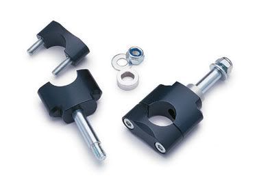

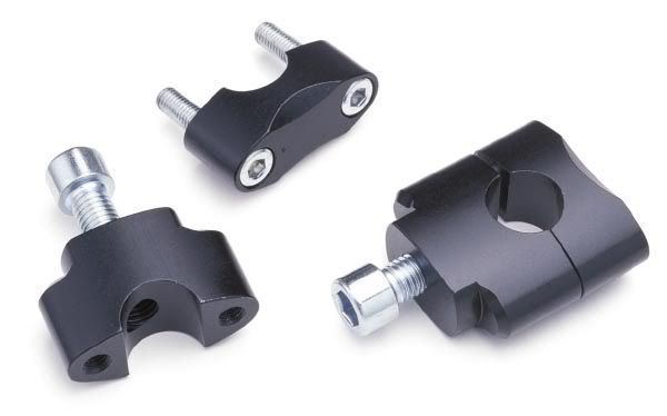

im planning on buying fasst flexx bars and i need a 1 1/8in clamp. i want to get the tag clamps but there are 2 different types of clamps. should i get the first ones or the second ones? thanks
5,620 Posts
Hmmmm .... i dont think either one of those will work. I will have my own line of clamps VERY soon. These will be the same as my anti vibe clamps, but work with your stock stem. They will look sweet. They will not raise the bars way up and look goofy.
Yeah...I am not familiar with that style. The ones I had..... fit into the bottom part of the stock clamp.
I know that sounds confusing.
Just make sure you get the lower bend bars --- the cables were really tight w/ the ATV bend and a clamp.
I would call to verify you get the clamp you need.

i found this one from trailtech, but it also comes with a plastic piece that holds those three lights and i already put them infrom of my gas cap. would i be able to use these and not put the plastic piece on?

ok nevermind i found these clamps. i see how they fit into your stock bottom clamps.
do i need to get new lines for anything with these mounts and with the atv bend fasst flexx bars?
Got your PM.... well you already answered your own question. :)
[attachmentid=675]
I would recommend getting the moto-bend.
Clamps + ATV Bend = TIGHT cables -- (you can re-route the cables a little)
Good Luck
Look how tight the throttle cable is with this clamp ---- and that's pointed straight. A right turn will pull.
No way the ATV-Bend Flexx will work with these --- BUYER BEWARE

thanks djvolume i'll get those type of mounts u said. now all i have to do is wait until my dad lets me get the bars. im in the middle of buyin a truck and he wont let me spent any money yet. so that suks :( . i should be able to get them soon.
19 Posts
i bought the trail tech mounts and know first hand that the cables are not nearly long enough.
33 Posts
I have Fuels clamps with Fasst bars perfect fit thanks Fuel
6,700 Posts
What I use also. Wish Fuel woulda had his out before I got these though.
