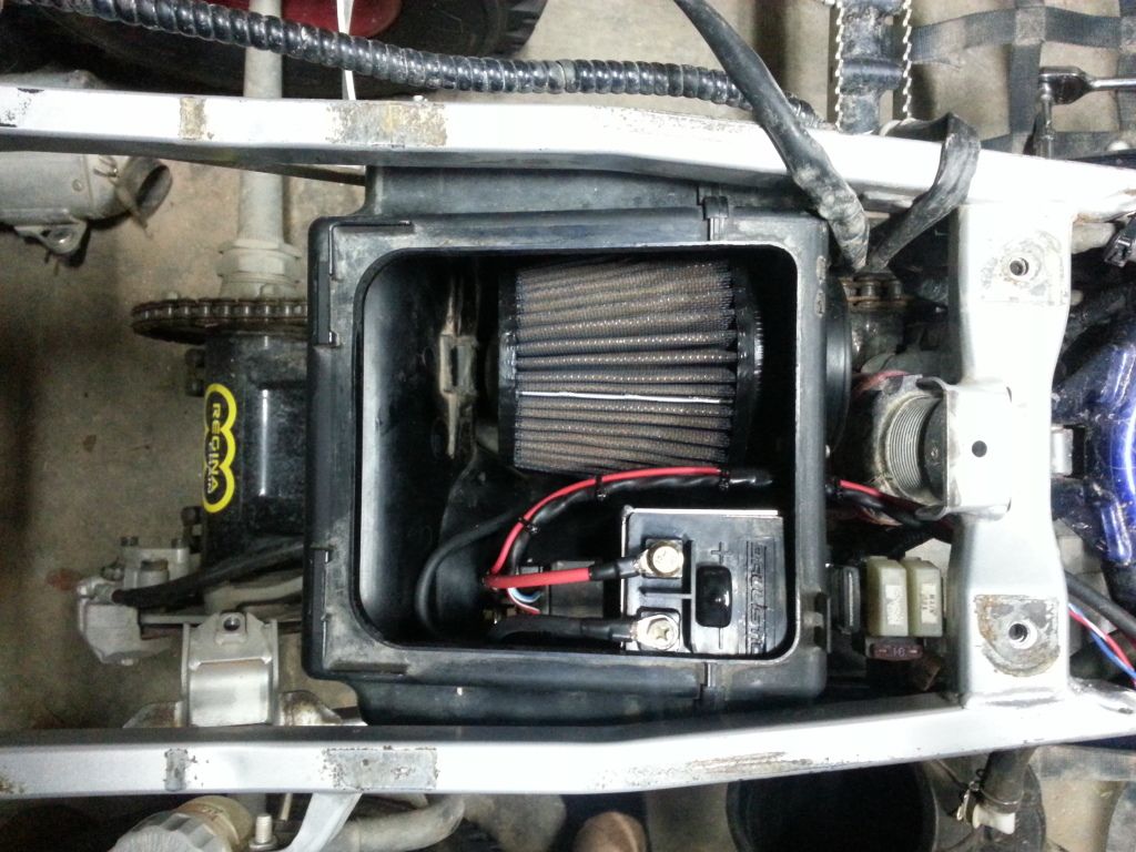

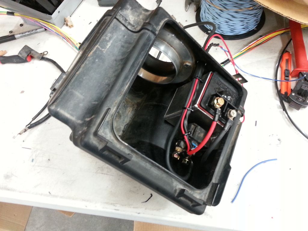

I've been slowly working on a little project. It could be used with the larger filter setup as long as the box was opened in the back. This prodesign kit with k/n slides right in. If you've seen the batteries they are .8lb and more then enough cranking amps. I also eliminated the stock battery box, vent canister, and soon the fuel pump will be in an aluminum tank. basically as light or lighter then a kicker kit. Its just mocked now, still need to finish everything, but the starter solenoid is inside the box, main fuse in front of it.

I like it, it will help the rad flow a little bit more air and clean up the look of the side of the bike. If the price is reasonable I would be intrested.

I like it! Show us the original battery location and how it's all cleaned up.

how much was the that battery? i was thinking of something similar but placing the battery in front of the radiator between the frame rails.

they are right around 100, I considered that location, but went against it. I wanted to move the relay and fuse block, and everything is already pretty tight under there. I think I mentioned I'm working on an aluminum tank, my original plan was to knock the front corners off the tank, (again I'm mainly track riding the bike) use one side for that battery and one for the electronics. That may still happen, but I'm still working on the pump fitting at the moment.

i had first wanted to use that area but the muffler plus the large kn filter take up all the space. how well does that battery start up your engine and how much compression do you have? ballistic says they dont recommend the 4 cell for larger than 300cc thumpers. so im just curious.
