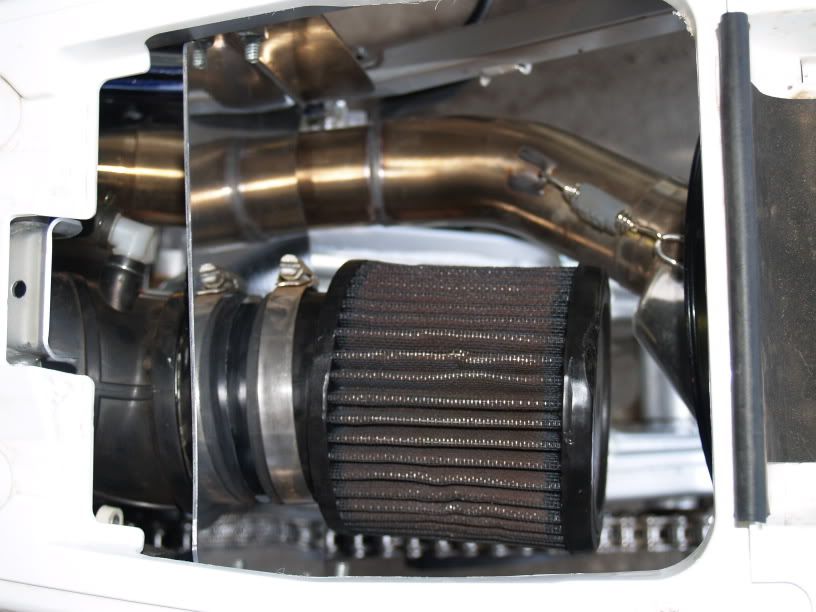

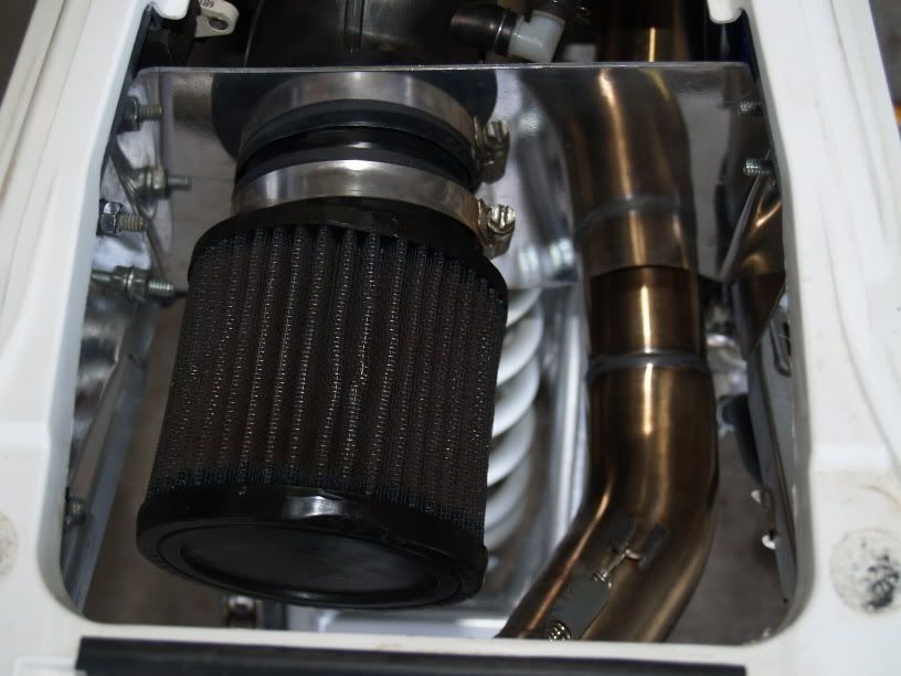

I'm getting prepped for a trinity air filter kit. In the meantime, this bracket should work on my current setup. The air temp sensor will be mounted to the plate(it is zip tied away from the heat right now) after I mount up the trinity set up. Took the outerwear off so you can see it better.......
I had to polish it to make up for the sloppiness of my work.
What do you think about the metal transferring the heat from the exhaust?
I do see what you're saying. It does have at least a 1/4" gap all the way around. I just might take more material off while I'm at it. Thanks
I went and checked and I had around 3/4" in the picture. I now have over 1" clearance all the way around. I let it idle for awhile and didn't notice much or any heat transferring to the bracket. I will watch it on longer rides. Thanks
Looks good. I'm gonna have to "man up" and try one out of aluminum :D

Just wanted to follow up on this thread. After running the bike hard for hours on the sand, I would feel the plate right after a ride. VERY little heat was transferring to the plate. It was even less than I had expected. Also, the outerwear was pretty close to the pipe and it did not melt or wasn't even warm feeling. I suspect the filter is getting less heat while moving than most think it is. Very pleased overall.
1,017 Posts
Bro you could sell a couple of those forsure. Nice work. I would maybe cut a say 3" half circle out right over the exhaust. That would work. It looks very strong.
What Fuel said and add a little of the heat tape...you can get it from Summit, sticky on one side and looks like aluminum foil on the other...the cooler the air the better.
Looks GREAT Clone...
